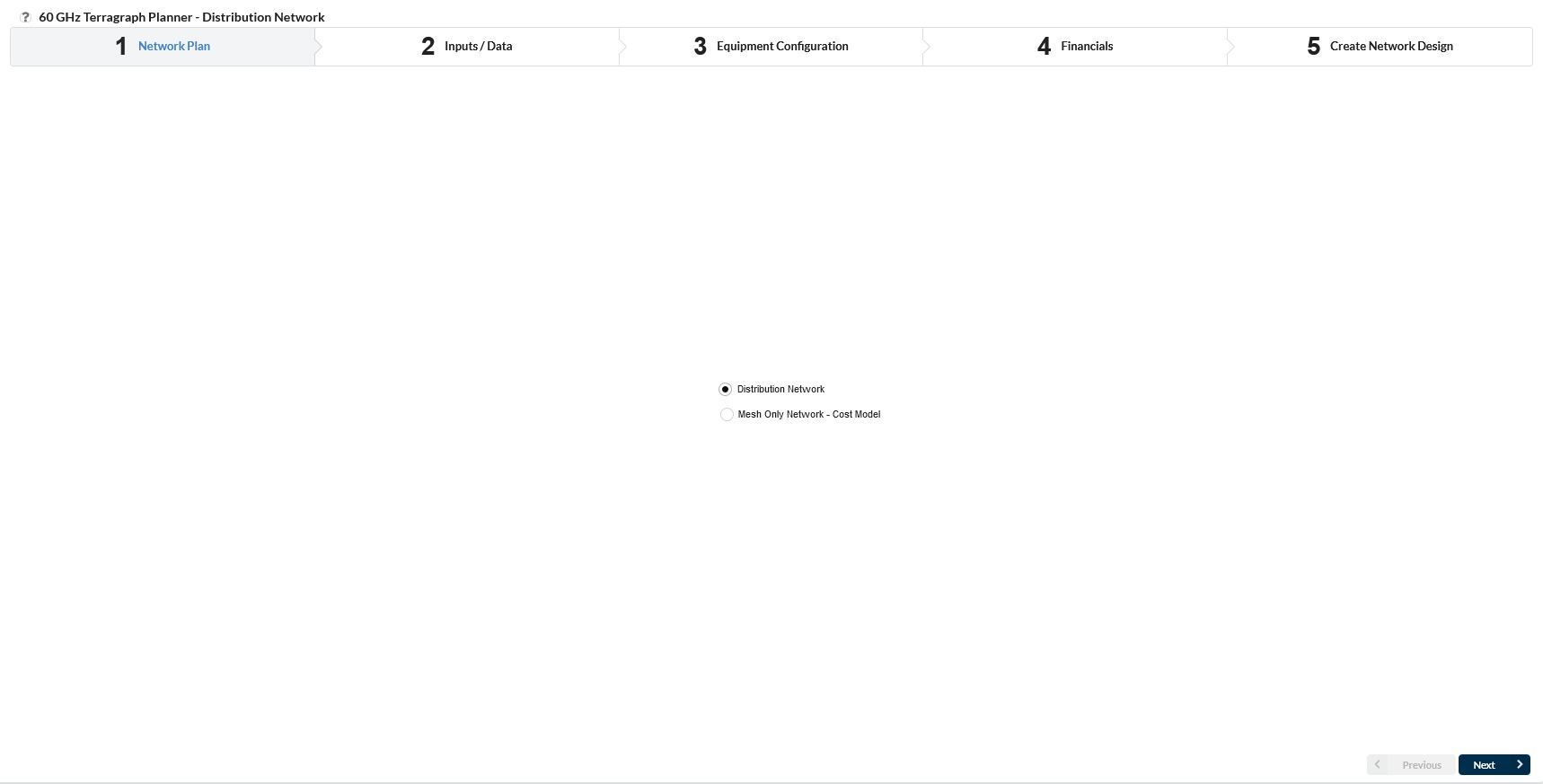

Step 1 Network Plan¶
Network Plan¶
Choose which type of network to plan by selecting from the following options:
Select Distribution Network when the subscriber locations are known
Select Mesh Only Network - Cost Model to only plan the mesh layer. This model uses the POP and DN locations as CN demand locations
Then click ![]()

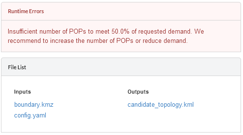

Failed Analysis¶
If the analysis fails a message is displayed to provide guidance on what might be wrong with the configuration. Click
 to go back and update the settings.
Check the candidate topology file to ensure that there are enough LOS paths, particularly to give connections to the POP sites and on the mesh backhaul. If the heights are too low and too many paths are obstructed the analysis may still see this as having too little capacity available.
