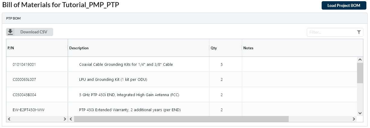

To calculate the Bill of Materials for a project select Bill of Materials,
  from the left hand menu options and then click on Load Project BOM. The Bill of Materials for the project is split into four sections:
PTP BOM - contains an aggregated list of all the Network Device equipment required to build the PTP links in the network
Bill of Materials for Project PTP BOM¶

The project BOM contains the list of part numbers and associated quantities for the complete project. It includes all the main components required to install the project as configured in LINKPlanner, including antennas, radios, modems (if required), upgrade keys, cabling, lightning protection and GPS sync boxes (if required). It also includes all optional extras, which have been specified at the device or link level, including cables, accessories and spares, Comsearch, installation & mounting, power, security and warranty & support
P/N: The Cambium part number. If the component is not supplied by Cambium, this is set to ‘(no part number)’.
Description: Description of the components.
Qty: Quantity required.
Notes: Displays information about certain items, such as whether they are obsolete.

To create a CSV for an individual section of the BOM, click
  while viewing the section of the project BOM required. Once in the spreadsheet the file can be saved as normal.
