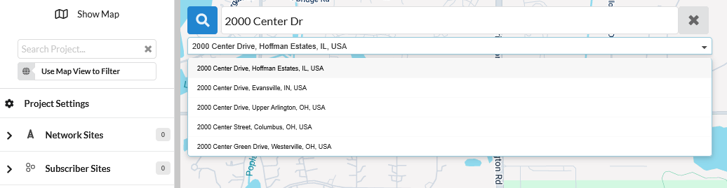

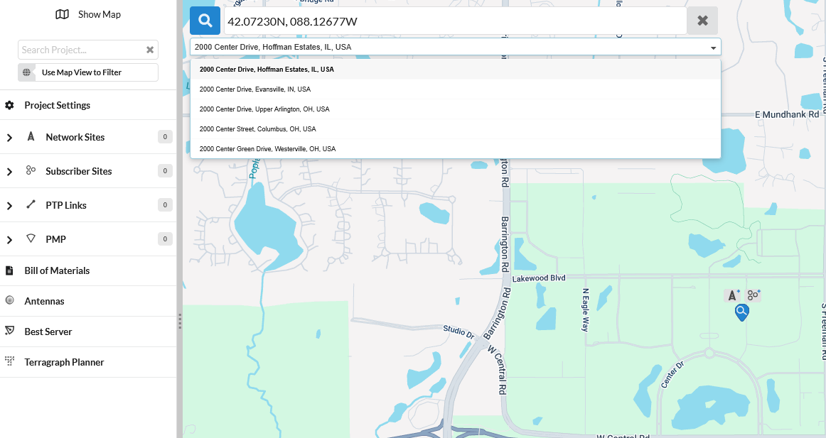

Address Search¶
To search for an address and create a Network Site or Subscriber Site at that location, click
 icon located at the top-left corner of the map, then enter an address or latitude/longitude to search.
Address Search¶
To create a Network Site at the searched location, click
. To create a Subscriber Site at the searched location, click
Creating Sites at the Address¶
