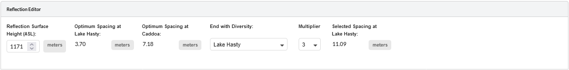

The reflection editor shows the Optimum Spacing at each end, see Unlicensed Band Reflection Editor. The optimum spacing may be different for each end of the link. Choose the end of the link to apply the diversity spacing based on the physical constraints of the towers.
The optimum spacing is the smallest spacing that will cancel the reflection, however it may not be possible to install the antennas at this separation, depending on the size of antennas selected and mounting points available. If a larger separation is required choose a Multiplier from the pull down list to give a suitable spacing shown as the Selected Spacing. In the example above, the Multiplier is set to 3 to give a spacing of 11.09 meters, which is easily achievable without much cable loss.
The unlicensed band radios are mounted to external antennas to provide diversity spacing. The Optimum Spacing requires the minimum cable length and hence the minimum additional loss from the single radio unit to both antennas. When using a larger multiplier the antennas are further apart and require longer cables to connect from the radio to the two antennas, increasing the additional loss.
For unlicensed products set the Multiplier, then transfer the resulting Spacing value to the Configuration Diversity Spacing and tick the Reflection Mitigation box, as described in Configuration at Each End. If diversity is to be applied at both ends of the link, the Diversity Spacing at each end of the link should be entered as half the value given for each end by the Reflection Editor.
