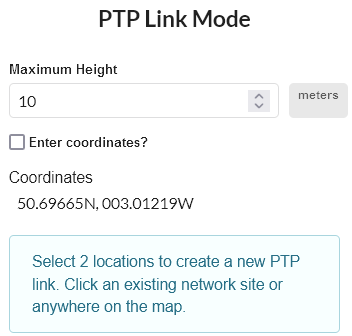

To create a new PTP Link from the map view, click new_ptp_link on the right panel of the project window. This opens the PTP Link Mode window
_images/new_ptp_link_mode.png
New PTP Link Mode¶
Set the Maximum Height (which is above ground and is used at both ends of the link). Then either click on the map at the required location for the first end of the link, move the cursor to the required location for the other end of the link and click again or tick the Enter coordinates? box and enter the coordinates of each end of the link. When moving from one end of the link to the other on the map the length of the link is shown on the dotted path or the link length is shown below the coordinates when entering them in the PTP Link Mode window.
note
Latitude and longitude should be separated by a comma. For example, 39.75093N, 104.84035W
